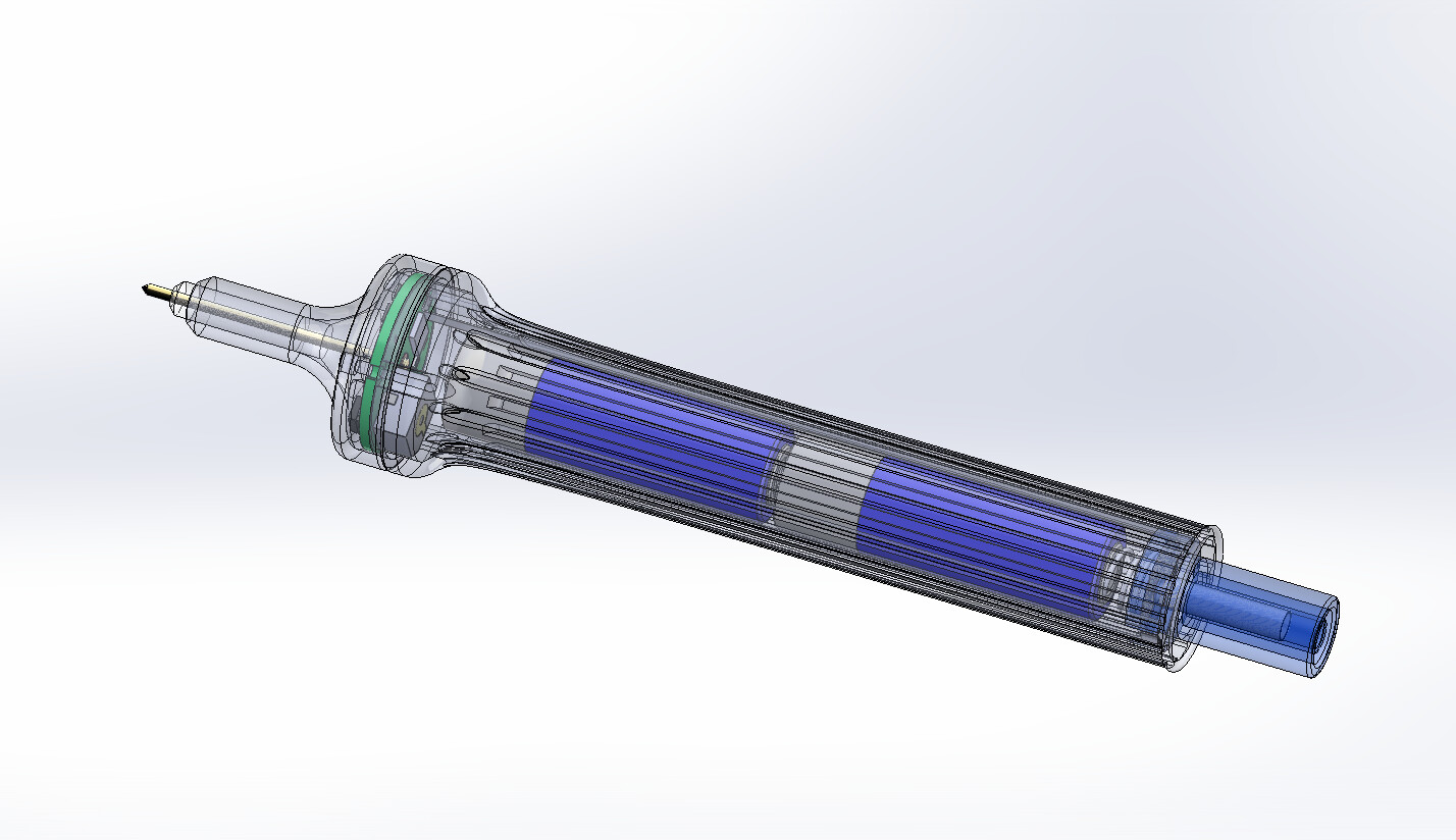

I have been thinking about a reboot of the Ultimate Continuity Tester.
The one thing that annoys me about the boxy simple unit I built is the fact that I need to take my eyes off the probes to see the LED, that’s breaking my flow.
This image is a concept I have been playing with: The tip has a transparent plastic light guide, with LED’s on the base PCB, it brings the light right to the tip.
You would plug a single banana probe into the back end, and that’s it.
The circuit would remain the same, just a mechanical redesign.
